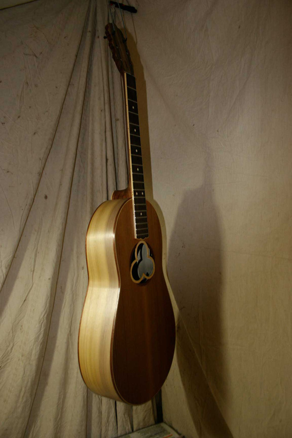

Hello everyone,
I'm having a problem when I put the wash coats on my cedar tops, I am
doing the application based on the Milburn tutorial.
Anyway, when I rub the first wash coat on it soaks in (more where I first
touch the cloth down and less as the cloth dries out) and when I come
back over the aria that was dryer with a reloaded cloth it stays lighter in
color
The color doesn't seem to even out if I go over it again.
Has anybody had this problem? Any ideas on how to fix it?
It seems like if I had a way of applying a even wash coat that didn't dry up
like the cloth does I might not have this problem, maybe if i used a
brush???
Any help on this issue would be greatly appriciated
PostPosted: Fri Jun 01, 2007 9:01 am
Jeb, I'm a nitro guy myself. My guess is you just need to keep at it and it will even out as the coats of shellac build. Good luck, how about backing off that puppy and giving us a full shot of what you are working on, looks nice, what I can see... bd

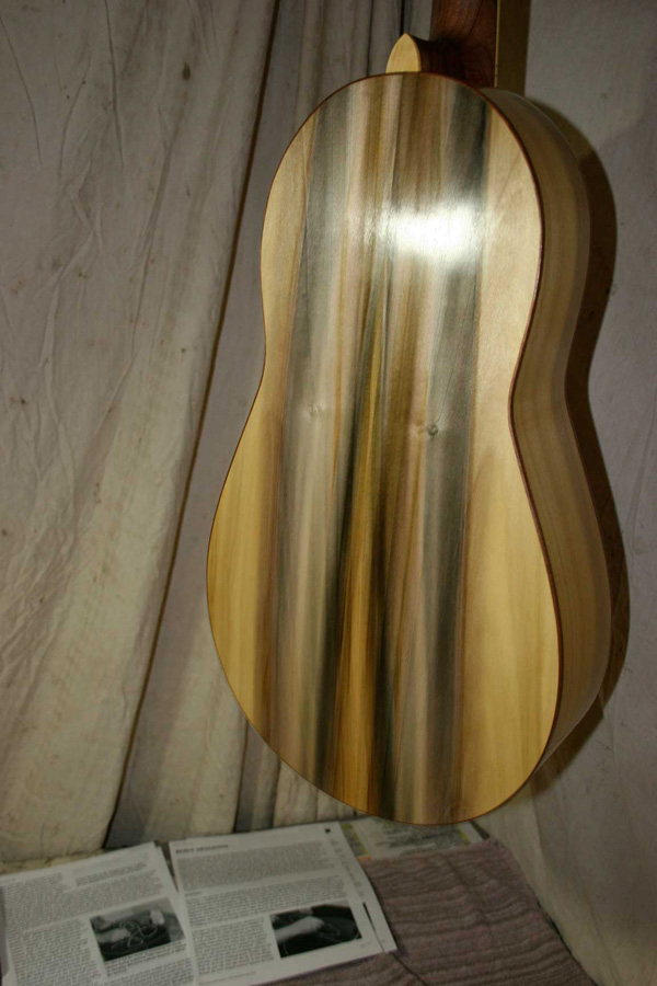

Bruce, I guess I'll do some experiments on a scrap and see if it goes away,
Here is a full shot with just the wash coat and one of the back with the
first bodying session (no issues on the back or sides)
Michael, I did a 2lb cut over the whole thing doing the binding/purfling
etc. first, in a single pass to avoid staining.
When I first noticed it I ended up sanding the whole top back, started
again and it did the same thing but, at least I was able to figure out what
was happening.
